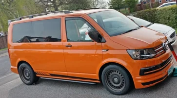

Iv got a project I’m working on (not the one in my pic) and I’m in talks with Duchy Banded Wheels in regards to making some 18” Amarok steels into 13” rears ( don’t ask ) and 9.5” fronts as apposed to 9 inch fronts.
Does anybody here run or know of anybody that runs 9.5’s on the front? Is it practical? I’m planning on rolling the arches a tiny bit if that helps. I’m also going for quite an aggressive stance look so not hoping to tuck them under the arch too much.

9.5" fronts have been done but many of those that have attempted it have reported fouling and rubbing on lock, although I don't think anyone has done 9'5" Amarok 18s on the front.
I've had 3 sets of Duchys banded 18s and they always seem to sit lovely on his standard banded widths. I'm currently running a set of his 19" Range rover space savers that are 9" and 10" and judging on my rears you'd possibly get another half inch if you pushed it, making them 10.5s but the various conversations i've had with Jamie, he doesn't like going over what he knows works.
I for one would love to see how a 13" banded 18 would look, because I suspect he won't be adding the extra you want to the outer dish of the wheel, giving a rather extreme depth, more likely if he is going to do it, he will share the extra width with the inner and outer, but either way I cannot see it fitting without either a wide body arch (which I have seen done twice on a Transporter) but bare in mind that route meant the side loading doors couldn't actually be used because they wouldn't open. Or, some major inner arch work.

I have 9's on the front and 9.5's on the rear, any wider (to be honest even the 9.5's do) and the tyres will foul on the side door as it opens, too wide and you may not be able to open the sliding door.
