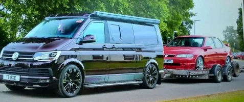

No issues what so ever dragging this from Chester to Northampton and back. Awesome motor to tow with.
