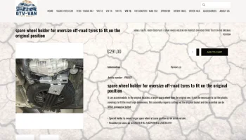

well lads that's been an education, I'll let all that sink in and be back in touch when I get round to dealing with the tyres. Someone recently told me not to mount the spare tyre on the back door as it would not be able to take the weight, what's your thoughts on this. Ill be looking for all terrain ones for myself so suspect they may be on the heavier side and too large for the under carrier.
I also just found this if its useful to anyone Screenshot 2022-11-21 at 18.03.38.webp
I also just found this if its useful to anyone View attachment 179923
This looks seems similar to the Seikel aftermarket version.
