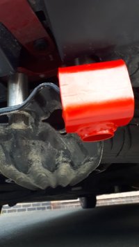

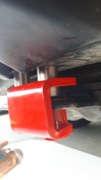

2020 plate T6.1 originally with 16" wheels, I changed to 17" swampers. I have just fitted a 235/55/17 steel wheel on my spare wheel carrier. Firstly I had to drop the front end of the carrier to it's lowest setting. I then found that the original retaining bolts were not long enough to reach the threaded bracket and allow me to bolt up the carrier brace. I got a longer bolt (90mm) that came with a spare wheel security kit, fitted it and tightened it onto the carrier brace. I then found that the carrier brace was compressing the side wall of the spare tyre causing it to depress inwards. If I backed the bolt off so as not to depress the tyre wall the bolt was too loose and would vibrate and fall out eventually. I now need to sort some steel tube spacers, cut to the correct length so as to put them onto the security bolt and tighten the bolt up fully, nipping the spacers tight, but not compressing the tyre wall. Ideally I should chop and refabricate the end of the carrier brace at the bolt holes end to make it deeper to accept the bigger tyre, but I will see how get on doing it with spacers first. I hope this makes sense and saves someone a struggle.
Following on - I cut 2 short lengths of SS pipe at 450mm long. Lowered the carrier and located the anti-theft device onto the carrier and around the SS pipe. Greased the threads of both bolts then inserted the 90mm security bolt through the carrier, then through the ant-theft device, then through the SS pipe and engaged it in the threads on the carrier bracket. Once the 90mm bolt had gone into place a short way I put the second shorter bolt through the carrier, then through the SS pipe and entered it into the threads on the carrier bracket. I tightened each bolt evenly until each respective section of SS pipe was clamped and sandwiched tight between the carrier and the carrier bracket at the same time shrouding and protecting the exposed length of the 2 threaded carrier bolts. The carrier is now bolted up tight to the carrier bracket without compressing the side walls of the 17" spare tyre. I will in due course change the shorter bolt for another 90mm bolt which will make life easier when accessing the spare.
