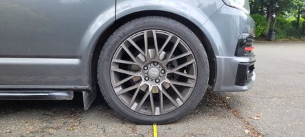

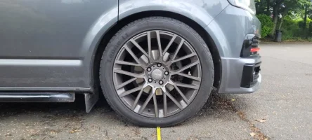

Hello, could anyone please tell me what these wheels are, came on the van i purchased last month but have no information on them.

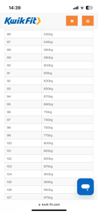

Pretty sure a 99 load rating is not suitable for a Transporter unless it’s a T26?
Well spotted that man!
From Kwik Fit 99 = 775kg per wheel.
Gives 1550kg per axle.

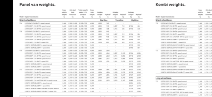

From early T6 brochure. T26 and
Euro 5 (non adblue) T28.
Yes you are all correct, Steve at CRS pointed this out to me last week, new tyres are due to be delivered tomorrow, some sparkly Nankang AS-2.
Any idea on what the wheel is ?
Momo revenge 20" anthracite
No idea, I’m afraid. Took an overly long tea break earlier and Googled 5 spoke alloys.
Came close, but no cigar!
Could you remove one and see what’s maybe moulded/stamped on the inside?
Yes I have spent quite a bit of time googling with no joy.
Yes that is a last resort to remove, I am being lazy !
Would like to know if they are actually load rated for the van as it may be a case of getting new wheels for the tyres.
Hi Andy, Thanks for that, I had actually got behind with a mirror and confirmed what they were and you are correct.
Unfortunately only load rated for 735Kg so should imagine these are for a car - Not sure which ones share the same bolt pattern and offset, etc.
I didn't even think to look into these things when I brought the vehicle but new wheels and tyres correctly load rated for my T32 will be delivered Tuesday, then I can get on with driving it about again.

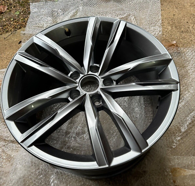

Hi!
In the market for these VW Springfield wheels.
Can you help me identify if these are real? I am planning to drive 2 hours this evening to pick em up.
Is there anything else I should ask for? Owner says they are original.
Much appreciated!
Thanks! The owner didnt picture the entire inside of the wheel, i've only seem the VW logo. Hoping that would be enough.
I will look for the OEM partnumber:
7E0601025Q
