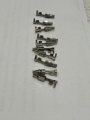

Im not familiar with the THQ lighting units you have but if the foglight is present on the other side then all you need is a few metres of wire and a JPT crimp to go in the empty slot in the wiring plug and you can have the other foglight working (with or without the original one)
Wire and crimp are only a couple quid and a couple hours to install and connect the wire

Thank you @Pauly ! This is exactly what i was thinking i could do!
Would it be as simple as removing the fog light power pin on the right, removing the VW crimp on the wire and and joining with a water proof inline connector? Or is there another connector that allows me to keep the VW crimp on the end incase I want to revert it back in the future?

I’m not sure about the setup on LHD vans but UK RHD vans that left the factory with halogen rear lights only have 5 wires going to each of the 6 pin connectors for the rear lights, one side is missing the fog supply and the other is missing the reverse lamp supply
Vans that leave the factory with LED rear lights have all 6 pins populated in both sides and have 2 x foglights and 2 x reverse lights
If I was you I think I would run 2 wires side to side in the rear and populate those empty slots and tag the wires into the relevant one on the other side
