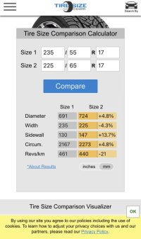

T6.1 Transporters and matching wheel circumference variants
| Van | Wheels | Tyres | Wheel Circumference (mm) | Matching Wheel circumference Variant | Result Reported |
| Factory 16" | 16x6.5 | 205/65R16 | 2114 | 1 | |
| Factory 17" | 17x7 | 215/60R17 | 2166 | 3 | |
| @JimmyAK | 20x8.5 | 275/40R20 | 2287.1 | 6 | |
| @ascotvan | 17x8 | 235/65R17 | 2316.3 | ? | my van, wheel circumference variant not yet changed |
| BFGoodrich | 17x8 | 225/65R17 | 2275.5 | 6 | |
| @Bluephantom | 16x8 | 235/70/16 | 2310.3 | 6 | Speedo = 100km/h, GPS = 98km/h |
| @ldm82 | | 245/65R17 | 2357.1 | 8 | |
| @Desmoben | | 245/65R17 | 2357.1 | 8 | Speedo is now about 4% on the optimistic side but still better than the other way round |
