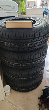

On my T32 (running Solow's) I currently have 225/55/17 tyres on my Fuel Zephyr's. I'm having 235/65/17 Falken Wildpeaks fitted next Tuesday at @BognorMotors (after they fit their new Bognor' Edition Bilstein Coilovers).
The 225's are a good fit in the arch at the front but there is room for an extra 5mm. It could easily handle going wider at the rear. If it wasn't for ground clearance issues I would have kept the Solow's but I need to go up a little and they're currently running at maximum height.
I'll post a pic when it's done.
235/65/17 Falken Wildpeak on Fuel Zephyrs. Sat at approx 70mm down on BMVS Edition Bilstein Coilovers. There is no noticeable increase in road noise compared to the Goodyear Efficientgrip's fitted previously and the speedo matches GPS exactly.
Liking that a lot, are the tyres 235/55 or 235/65 as previously suggested? any rubbing at 70mm?
235/65! Post amended :whistle:
No rubbing yet, but I've only driven home and round the block. They're obviously bigger tyres but seem to sit at pretty much the same position in the arch as the 225/55's did with the Solow's, even if they are slightly wider. The 225's only rubbed once in a big depression with a bit of lock on so I don't forsee any issues with these. I will probably add a 10 or 15mm spacer to the rears.
