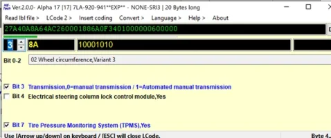

Hi, I changed the variant to sort the speedo out on my 6.1 when I put 245/46 r17 BFG A/T's on, I ended up on variant 8 before the speedo was correct.Hi, I changed the variant to sort the speedo out on my 6.1 when I put 245/46 r17 BFG A/T's on, I ended up on variant 8 before the speedo was correct.
However...... I have since changed to Cooper Discoverer ATT 225/65 R17 (found the BFG's too heavy and braking wasn't great when fully loaded) and can't change the variant back so stuck with a speedo reading a bit over. Seems a few people have seen this to proceed with caution.....

Hi, did you change both of these values:However...... I have since changed to Cooper Discoverer ATT 225/65 R17 (found the BFG's too heavy and braking wasn't great when fully loaded) and can't change the variant back so stuck with a speedo reading a bit over. Seems a few people have seen this to proceed with caution.....
VW Transporter T6.1 2021 Wheel size coding changes issue
Hiya folks! A customer of mine changed his wheels to 20" and wanted his speedo coded to suit the new wheel size. No issue as this is an available change via the "K-Number" coding in 17 Instrument Cluster and done this many times in older Transporters and Amaroks. Well, turns out there is an...forums.ross-tech.com
00845 wheel circumference average
00845(again) wheel circumference maximum
to variant 8? And did it have any effect on your ACC?
