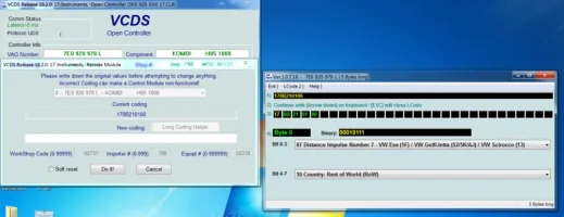

Hi, and sorry for delay, I have now been through to step 4 and have enclosed the relevant screenshots, considering these, how would you advise I proceed and what values would i need to change please?
Thanking you in advance, this is al really helpful.
Almost there. Now we know how your van is coded (Distance Impulse Number = 7).
Sorry forgot to mention that you need to "tick boxes" for those two measurement value to get the needed values (wheel circumference).
Then the needed values appear in the other window - as example below
Could you please provide these.
The next step would be to change the coding to "06 Distance impulse number 6..." and read again the two values above.
