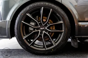

Finally got my Amorok’s fitted.... after weeks of trying to find a decent deal on a tyre I finally bit the bullet and went with a set of 275 40 19 105y Nexen. The ratings are brilliant and reviews were were very good too.
Well, here’s a before / after. Now I need to get the sportlines re-furnished and powder coated and my winter tyres fitted.

look really nice. Where did you go for tyres? I’ve used blackcircles in the past for convenience of fitting at home and also if you get a discount code!
I ordered the tyres off Camskill as they ended up being cheaper than Oponeo, Black Circles and Tyreleader.
I then used a local tyre fitting company who i've been using for 10yrs to fit the tyres, move the spaces from front to back, and mount the 19's.
I already had 10mm spacers up front so those went to the back and the alignment of the outer wheel edge front to back is really good.

Hey pal, i went with the 275.40.19 105xl. You don't need a spacer for them to fit / not scrub. I am running a 10mm spacer on the rear with longer bolts though just to get the look i was after.
