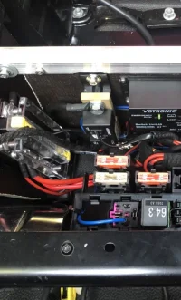

I removed the relay and took power feed away from it’s socket and attached it to bus bar, from there onwards to dc-dc via smaller fuse. So: main battery -> 100A fuse in ebox -> 80A fuse under seat -> bus bar -> 30A fuse -> dc-dc.
The ign feed is the one that drives the relay. I just left it to it’s place and took it from relay socket to dc-dc charger by a spade connector - see photo.

Yeah, exactly, just remove the relay, and the DC-DC is almost an exact replacement with the addition of a ground feed. The input (i.e. from starter) goes to the input of the DC-DC, the output (i.e. to leisure battery) goes to the output of the DC-DC and the signal wire goes into the 'ign' or signal feed of your DC-DC - all with appropriate fusing...
