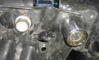

Taking inspiration from this thread (thanks DXX), I have now beefed up the standard 3 pin locking nut with a ½" / 1" socket that I had lying in the bottom of a toolbox (knew it would come in useful one day!). Fitted perfectly and didn't need any cutting / grinding down. I'm just hoping that any thieving toerag will take one look and decide that there's an easier one to nick down the road:

I don't actually think it's a major issue (at least not on mine with a 16" spare fitted) but you could always use a stack of washers. That said, it might be wise to use stainless steel as others might rust quickly in wet weather (which is something I'm a little concerned about with my socket mod above but I'll keep an eye on it).
