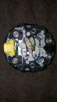

You can swap the looms as they are only spade connectors and clip onto the back of the air bag . When did mine i put the loom off the back of my wheel onto the the new gti wheel i bought as they were different. All worked ok but i dont no if it would be the same with the ACC type controls :unsure:
This is the loom on the back of the air bag , i think there all the same but the wiring is different in them depending on what spec and model you have.
Would the buttons split from the back of the steering wheel do you know as i could just add the acc button then presumably if the loom will fit ?
I managed to find a new GTI polo steering wheel with DSG paddles and air bag. I wanted the red stitching and the red illumination on the switches to match the rest of the dash, so following the fine work and advice from @RattyMcClelland i new what steering wheel i needed to achieve this. The only problem i encountered was i could see the wiring loom on the GTI airbag was different to the T6 wheel. I installed the wheel and bag as it was wired just to see if it worked . It did.... apart from no horn or cruise control :confused:.... So i swapped the T6 wiring loom onto the gti air bag and result it all worked perfectly paddles and all :). So i think thats all the steering wheels covered for what ever type and version you would like, @T6 dork has done his conversion to paddles and flat bottom wheel with the standard airbag.
so if anyone else wishes to do a steering wheel mod you know what to do now and what works :thumbsup:
