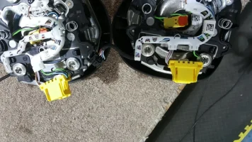

Cheers pal your a good oneFrom what i could tell the looms on the back of bags are the same but with different wiring to suit the controls on the wheel/model you have. As i have said i just swapped the loom from mine to the new air bag (round type) and all worked good. On right GTI round air bag, left T6 shaped air bag. Loom just un-clipped and transferred across.
