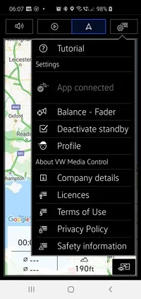

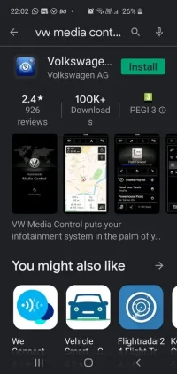

You need Media Control. An option like app connect. You can use it to control the head unit. You can de activate standby so it must be a coding thing.
Sweet.... I think I looked at this before...
But couldnot get it to work...
Time to try again....

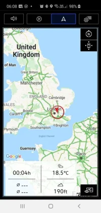

Ah. . . . . . It works now.
Both radio and phone connected to Van's wifi....
App now working.. =)

Does the VW app work with the basic VW headunit, or does it require upgrades?
And @t0mb0, how do you access the engineer mode?

I used OBD11, I assume it’s also possible with VCDS.
