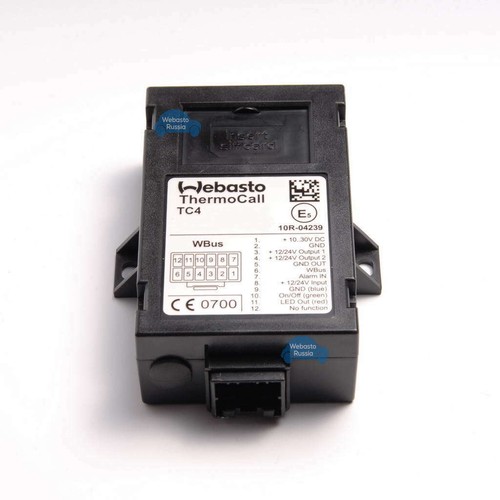

I found this and I don't know if, for the sake of €161=£146, I am going to resist.
  • Love
Reactions: mmi
I have only sold one heater with a TC4. Personally I think that they are just a gimmick - how many times do you want to turn the heater on when you are more than 1000m away from it ( Telestart max range)? By the time I have walked that distance the van is warm enough.
