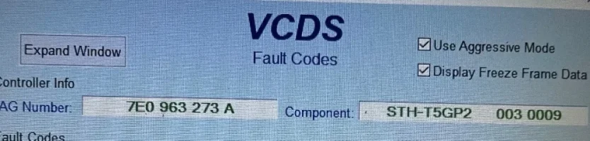

Hello,
I am new to the forum and have been reading a lot all the information about parking heater conversion. I own a Trendline t6 2019 with the basic webasto able to heat the engine and afterwards the cabin when temperature is under 4-5 degrees. Before going though the CAN conversion I tried the “cheap” way by buying these components:
Receiver: 3Q0963513
Remote control: 3G0963511E
Connector for Telestart module:m
Piggyback fuse connector for 12v and 1a fuse
Now: I see that the reflash file is
FL_7E0963272B__0009.frf
Whereas I have a 7E0963272A one.
Is this going to work to reflash the A version with a B firmware ? Or it is just something which is going to shot my A revision ecu ?
I am using the Odis-e VW reprogramming tool obviously.
Thanks a lot for your help !!
