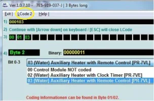

Address 6E: Ctrl Head Roof (J702) Labels:. 7E5-919-037-W2.clb
Part No SW: 7E5 919 037 G HW: 7E5 919 037 G
Component: Dachdisplay H15 0185
Revision: 10100011
Coding: 000103
Let us know how it goes... What's your controllers software version (see above the line Component: Dachdisplay H15 0185)?
Many thanks for that, the wife is out with the van at the moment, so will have to try tomorrow,
The software is H16 0185
I noticed the part number is also different, 7E5 919 037 F instead of 'G'
Its currently coded 000205
Hi there,
I've just tried recoding, but the only options it has given me for the last bit is 0,5 or 6
I've left it at 000106
I thinks its just an Air heater?
Hi there,
Just checked a few more scans and realized that you should probably target to coding 0102 (0103 is for a one with a remote).
EDIT: Actually I don't know if the clock timer (PR-7VE) refers to the older timer as the actual radio remote seems to be coded in the Webasto, in the module 18. So the 103 is still probably the best guess.
EDIT2: May be I have to to take the edit above back. Checked the build sheet and it interestingly shows a "matching" code :speechless:
You should be able to enter any coding either using subsheet LCode2 or just typing directly into the box on line 3) or 4) (see picture). Interesting though why the selections available are not the same - different VCDS version? What are the VCDS "explanations" for codings 5 and 6? I don't see those :unsure:
I found in my scans from a few T6s with this overhead water heater controller software versions H15 0185, H15 0200, H17 0200, so not surprised to see also the H16...
Also found another part number variant, from a brand new 7E5 919 037 J. The "G" above was a MY16. So shouldn't be a problem there - I think.
For byte 2 bits 0-3, I only have three options:
Control Module NOT coded
(Air) Auxiliary Heater with Clock Timer
(Air) Auxiliary Heater with Remote Control
I will get the exact wording, again when the wife gets home in it tonight
Maybe tonight I also have a look in the Subsheet LCode2
I'm just wondering if its a security code issue?
