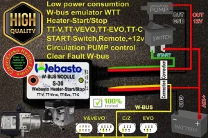

Hi Eugene,
no, on the contrary, I want to simplify, in the sense I want, like other people here, understand how your (or Fite-Wetzer) upgrade works. I thought my description was extremely simple and probably missing some point.
I will probably have to post some blockdiagram, since , you know, a picture is better than 1000 words.
See the picture below. I am NOT suggesting to buy that kit. But I think it is useful for reasoning.
Meanwhile, I am not sure what your proposed upgrade "offers".
-Does it command any pump for the warm water? Is there any electric pump in the base T6.1 at all? Since the aux heater runs only with the motor running, it can use the main mechanical pump that runs with the cam belt, but in our case that is obviosly not possible.
-Does it run the Climatronic/Climatic fans? Those fans normally run only with the key in "contact position".

Just for clarity - I am not offering anything. This kit is not for sale as I prepared it for a friend.
The photo of the kit I showed above is the factory way to allow the water heater to be turned on remotely or via the timer.
Any non-original kits such as the one in the photo in your last post are not compatible (unfortunately) unless they support LIN, which is vw-proprietary. W-Bus kits are not compatible.
Factory original upgrade turns on the fan, water pump etc. Fully automatic solution. And also the custom timers thru roof control panel.
