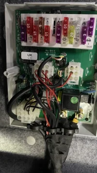

photos as best I can. As I can tell the black box is charger when hooked to mains, the box with 3 cab in it for the mains system, the ds300 just a distribution box.the leisure battery is standard fitted by vw, pics as best I can under the seat without removing the seat, no signs of any other electrical boxes…hope that may help .
You have the same set up as me. The ds300 has a relay in it to charge the LB when the engine is running and distributes the 12v power. It will also provide a trickle charge to the SB when you are on EHU. The black box is the mains charger for the LB (and starter via ds300) and is not lithium compatible if you plan to go that route.

Back! A lot has been covered while away. Great info. As mentioned, in essence connecting the MPPT to the posts in the DS300 is ok but it is tight and probably better to use some busbars to keep a single connection to the DS300. Pic of mine to show how tight it is:
It also worth having a look in the DS300 to see if the resistor has been snipped. If it has there is already a DC/DC hidden away somewhere. If it’s in one piece then the internal separating relay is doing the charging. As said above this will only give you about 80% charge due to the smart alternator. The resistor is in the bottom left corner of the DS300 and labelled ‘R37’ (some versions had a dip switch hence the on/off label too). Pic of my intact one here:

Having seen the bolt terminals I'd really strongly urge you to move the connection outside to a bus bar. There is not a lot of room there and it's not just "is there a bit of a gap left" when you nip them up you need to worry about but also what happens if everyday vehicle vibration loosens the nuts. Right now the cables will likely stay where they are and just hang there due to the loom, with 2 cables on the two left hand bolts in a V arrangement it's more likely the cable with more weight or tension is going to swing the cables together and short.

As for dc dc charger looking at the distribution box looks like resister r37 has indeed been removed so presumably somewhere hidden away is a dc dc charger already in the van…?
