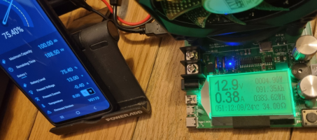

and having the kit out while testing the new ROAMER seat Base battery - Roamer LiFePO4 Gen2 230Ah Seatbase battery -- "How I Done It" --
i thought i would test the Renogy for LOW current to see if the BMS can detect low currents.
The Poweroad Heated version i have above DOESENT meter out currents less than an amp . . . <1A ( 1000mA)
so lets see how the Renogy W/Heater fairs . . .

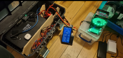

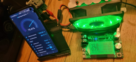

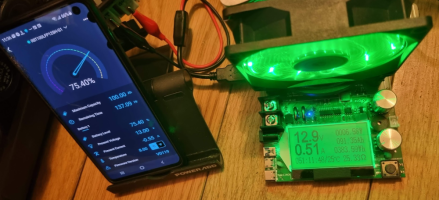

this is the setup. . .

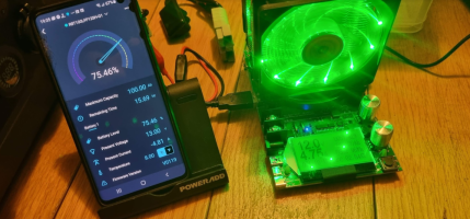

200w electronic adjustable load . . battery and BT-2 monitor with the APP.
starting high we can see no issues with 4.8A . . .
and 7.1A . . . .
so lets drop down low . . .

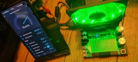

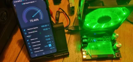

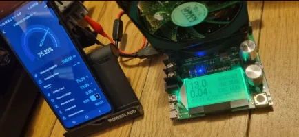

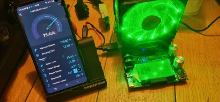

here we have 1.0A . . . . report fine by the BMS.
next we drop lower to . . . 0.8A ( 800mA ) - works great.
now drop to 0.5A (500mA) - still going =]
now 0.3A (300mA) - all good.
down to 0.1A (100mA)
at this point the BMS looses the ability to register any current flow.
That's amazing . for a 150A BMS . . . .
the Poweroad wont detect <1A
The ROAMER <0.5A ( but its 250A BMS)

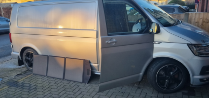

Gotta say im feeling like a kid on Christmas Eve . . .
its Winter 2021/2022 and we have finally had some cold weather ( in SE UK / London )
Now its not the six inches of snow i wanted . . . . but its good enough.
The plan is to finally test these Sub-Zero Lithium's and to test what they do when its cold and to prove the manufactures claims.
the forecast is -3DegC over night and a good 0C for the whole morning.
the test begins the previous night,
both battery boxes are left outside . . . but after 3hrs they were still showing warm above 10deg C.
So i decided that the Tool box was insulating them from the cold.
so i opened the boxes . .
jumping out of bed the following day like a kid on Christmas morning i looked out the window to a frosty winters morning . .
just what id been waiting for . . . . for almost a whole year (sure i could empty out the kitchen freezer to do the test . . . but think id have to deal with the world war 3 aftermath).
This what i saw the following day . . .
View attachment 140934View attachment 140935View attachment 140936View attachment 140937View attachment 140938
the battery's were showing a solid 0degc - perfect.
the temp sensors i added to the boxes we having a metldown . . . they were showing -5 degc .
but the button battery cells were showing only 2% charge . . . . those little batteries dont like being cold - thats for sure.
View attachment 140940View attachment 140941

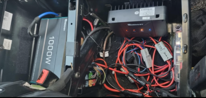

Went to the van yesterday that has beens standing idle for 7 days. The PowerRoad battery was totally flat from when I left it at 80%. The low voltage protection had kicked in.
I thought everything was switched off. I'd also turned the solar charging off in the Victron app too keep it around 80%.
Charged it up and I had a 0.5a - 0.7a phantom drain on it according to my BMV 712. Spent ages looking for it. Turned out the 13a socket, which has a separate, remote, on/off switch, connected to the Victon inverter was switched on with nothing plugged into the socket. Switched it off and the drian went away
No idea how that is happening!
inverters use standby power when switched on - even when nothing is connected to the 240v side.
so thats normal.
i have this Remote ON/OFF switch on my Victron inverter . . . - Victron Energy Phoenix Inverter Control VE.Direct - REC040010210R : Amazon.co.uk: Automotive
and as a side note . . . its good to run the battery down flat once and a while, it will help keep the BMS SOC meter in check. (top ballance/bottom ballance)
ie reset the BMS to 0% when flat - then recalibrate to 100% when fully charged.

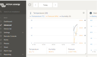

Ruuvi tags are nice little gadgets, good quality if not the cheapest. The openness of the design is very nice. That said, I have couple of those and they’re mostly just laying around unused.
Couple of years back I attempted to make a household energy monitor out of the Ruuvi by interfacing a photodiode to it and counting the blinks of the mains meter. I wrote custom Ruuvi firmware in Espruino to read additional gpio’s and used Raspberry Pi indoors to process the blink data received over BLE. Turned out to basically work fine but momentuous accuracy I desired was not there since you need to count blinks over such a long period of time to get a good reading. Maybe one of these days I should try to reprogram it to analyze blink frequency instead of counting the number of blinks over a time frame…
As it happens, victron just released v 2,72 that supports ruuvi, and many other updates. It’s a major one out, been on beta for some time.
That's mad !!! Well done you for giving it a go.

The RUUVI tags are in ---> Victron (#TeamBlue) Advanced Systems + VRM - How We Done It -

lets see how they perform.
we have the Poweroad LINC INFI 100Ah - 12V 100AH POWEROAD INFINITY SUBZERO LOW TEMPERATURE LITHIUM LIFEPO4 BATTERY WITH BLUETOOTH MONITORING - Alpha Batteries
and the Renogy 100Ah w/self heat - 12V 100Ah Smart Lithium Iron Phosphate Battery w/ Self-Heating Function

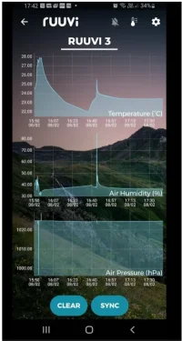

Thought I’d do an update on my powerroad sub zero battery.
I’ve just spent a week in Austria. the battery compartment was down to -5c and the outside was -12 to -15. the battery SOC was at 80%.
I turned the engine over, the red light on the Powerroad started flashing and I got warning on the app that ‘low temperature protection’ had been activated. The BMS had stopped any charging. After about 4 minutes the light went out and it started charging. This happened twice on a couple of days.
The battery is fine, it worked as advertised, the internal heat mat worked and I’m quite pleased with it.
The van was also flawless at 80mph on cruise for most of the way averaging 33mpg..
