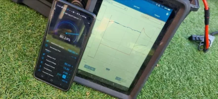

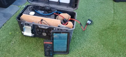

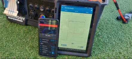

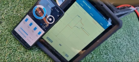

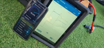

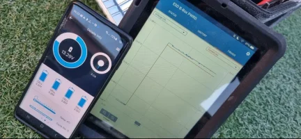

mid test results added to post above . .
current test results.

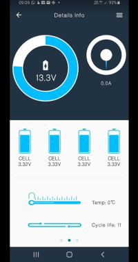

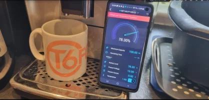

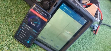

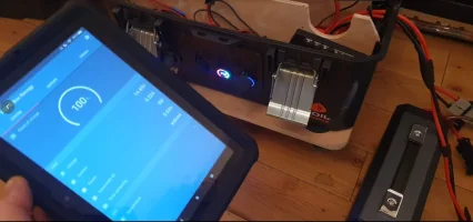

49 hours in . . . drawing 0.8A from the battery.
88ah @ 5v
battery BMS shows battery still at 100% SOC.
with no draw and standby status.
View attachment 127253View attachment 127254View attachment 127255
Vic SS shows battery at 63% SOC with the 0.8A load draw.
thats 41ah @ 12v
View attachment 127256View attachment 127257View attachment 127258
interestingly the battery hasnt gone to SLEEP yet . . .
i think the 800mA draw is under the 1.0A sleep point . .
but with the BM2 transmitting data to the phone we must be just be resetting the SLEEP timer.
800mA + 200mA ? - thats most likley whats happening.

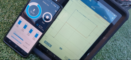

BM2 readout . . . . shows battery online for the 49hrs duration.
View attachment 127260View attachment 127261View attachment 127262View attachment 127263

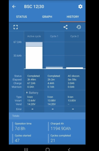

here is the recharge results.
battery BMS shows battery SOC @ 100%
Vic Shunt shows the REAL SOC @ 63% (100ah battery)

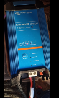

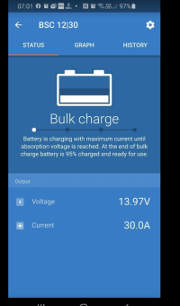

Vic 12/12/30 charger connected . . . delivering 30A to charge battery.
battery shows the 30A incoming . .

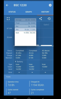

later that day . . .
charger shows battery full and STORAGE MODE . .
with 0A going into battery.
charger history shows 67.2ah went back into battery.
the breakdown was . . . .
56.2ah in BULK
11.-0ah in ABS

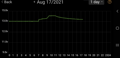

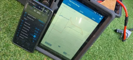

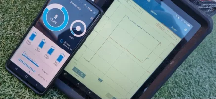

this is the BM2 voltage plot of the charge.
conclusion :
The battery BMS does not account for any loads under 1.0A, but will ABOVE 1.0A (confirmed by Poweroad anyway)
The battery BMS SOC may not be 100% accurate due to to the above (@Mick take note)
The Vic SHUNT SOC IS 100% accurate (@Mick take note - this is what i was saying at Camperjam - Trust the Vic Shunt over the Battery BMS)
The Vic charger proves the above by putting the 68ah BACK into the battery that the electronic load had pulled out even though the battery BMS showed 100% SOC throughout.

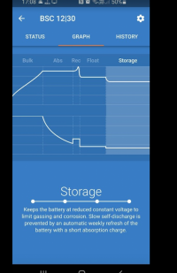

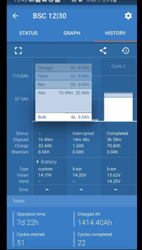

View attachment 127989View attachment 127990
56.2ah in BULK
11.-0ah in ABS

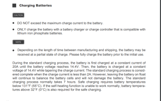

DESCRIPTION​
The Renogy Smart Lithium Iron Phosphate Battery enables the auto-balancing among parallel connections and provides more flexibility for the battery bank configuration. The integrated battery management system (BMS) not only protects the battery from various abnormal conditions but monitors and manages the charging and discharging process. The state-of-the-art battery cells ensures an extended cycle life and exceptional discharge performance. With built-in intelligent self-heating, the battery is rechargeable even in low-temperature conditions. If you’re searching for a deep cycle battery for caravan, cabin, or marine use, then this lightweight, auto-balanced, ultra-safe, long-cycle-life lithium battery is the perfect plug-and-play solution for you!
The Rover charge controller are fully compatible with this battery. If you have any questions regarding this product, please submit a case..
NOTE:

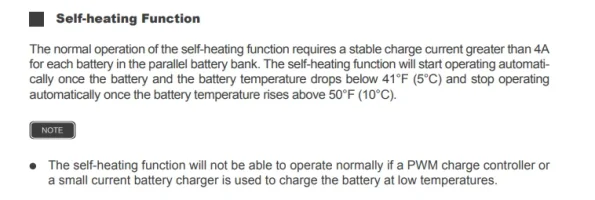

● The normal operation of the self-heating function requires a stable charge current greater than 4A for each battery in the parallel battery bank. The self-heating function will not be able to operate normally if a PWM charge controller or a small current battery charger is used to charge the battery at low temperatures.
● Please secure all cable connections to the proper specification in order to ensure good contact between the cable lugs and the terminals. Over-tightening cable connections can cause terminal breakage and loose cable connections can cause terminal meltdown or fire.
● DO NOT string the battery in series. ONLY connect batteries of the same manufacturer and model in parallel.
● Please avoid too high a voltage difference between paralleled batteries, despite the auto-balancing function, to avoid triggering the over-current protection.

Self-Heating
  • The intelligent self-heating feature keeps the battery charged in cold environments.

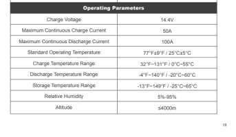

SPECIFICATIONS
Rated Capacity: 100AhInsulation Resistance: 500V DC, ≥ 10 MΩ
Operating Charge Temperature: 32~131°F/ 0~55°CMaximum Continuous Charging Current: 50 A
Operating Discharge Temperature: -4~140°F/ -20~60°CMaximum Continuous Discharging Current: 100 A
Voltage Range: 10~14.8 VCommunication Port: RJ45 (RS485 Protocol)
Nominal Voltage: 12.8VStorage Temperature: -13~149°F/ -25~65°C
Connection Method: ParallelCycle Life (0.2C, 25℃): ≥4000 Cycles @ 80% DoD
Dimensions:11.4 x 6.8 x 7.4 inch / 289 x 172 x 187.5 mmWeight: 26.2 lbs. / 11.9 kg
Certifications: UN38.3, MSDS, UL1642,UKCA,PSE,FCC (Lithium Cell)
Protection Rate: IP54

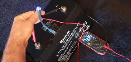

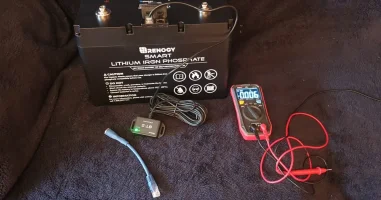

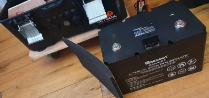

This is our unit we also go an additional BT2 bluetooth unit so we can use the BT APP :
its the 100ah version WITH internal HEATER - that means it can charge at full rate in SUB ZERO conditions.
Renogy do a standard 100ah version without heater - this can still be used in SUB ZERO temps, its internal BMS will allow outgoing load power . . . . but will BLOCK incoming charge power (down to -20C) . . . . the BMS will then allow full charge power when the battery warms up a bit (over+5C)
this is what you get in the box . .
these can be run in parallel if you want more capacity, but cannot be run in series . . . ie 24v bank.

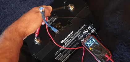

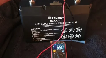

out of the box the battery is 66% SOC and in sleeping / storage state.
the terminals show a monitoring voltage of 5.5v
plugging in the sleep - wake button is voltage drops to 2.9v.
pressing the sleep button wakes up the battery and shows a good 13.36v

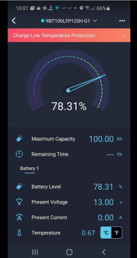

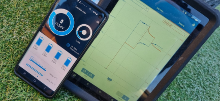

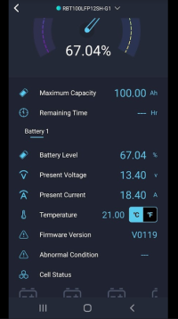

plugging in the BT2 dongle gives you access to the Renogy HOME BT APP..
with the APP you can read all the data stats from the battery.

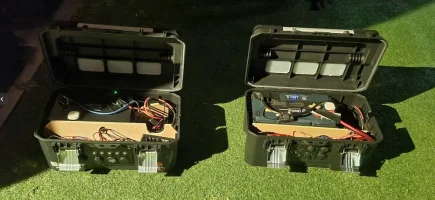

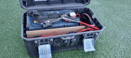

ill get this fitted into a mobile battery box and start testing . . .
more to follow.
related info:
- NEW BATTERY & TEST -
RENOGY 12V 100AH SMART LITHIUM IRON PHOSPHATE BATTERY W/ SELF-HEATING FUNCTION
Pt2

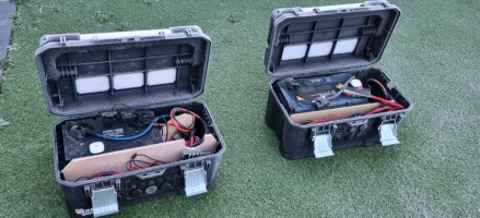

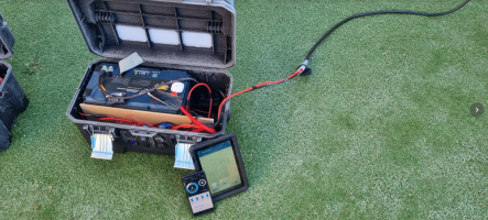

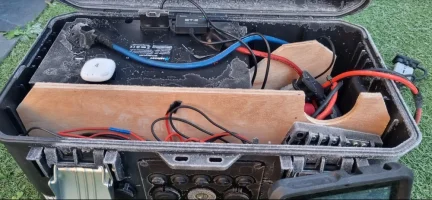

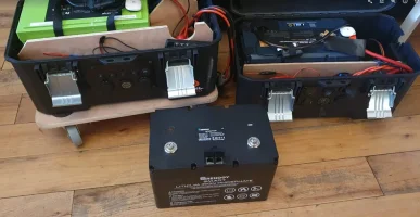

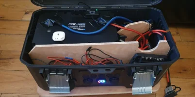

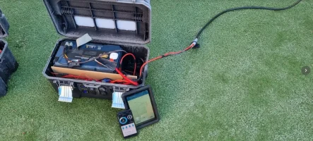

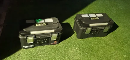

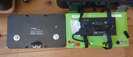

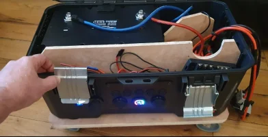

battery install into battery box and charge up.

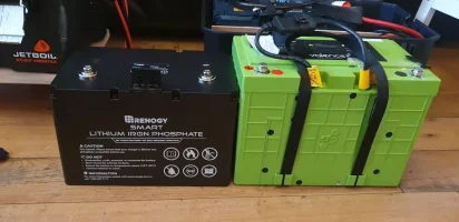

size wize its a bit smaller than the Valence.
a bit shorter in height . .
but same width . . .
taking the opportunity i added some 10mm dense foam to the base of the box.
the battey drops in perfectly . . .
then terminals covered for safety..
temp monitor velcroed in . .
and BT2 unit connected and velcroed in . . .
we are ready for a test.

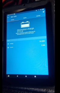

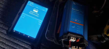

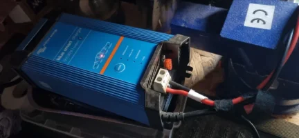

connecting the 30A Victron charger we are getting under 20A being pulled at 66% SOC which i wasnt expecting?
i was expecting the full 30A? (like the Poweroad and Valance would draw)
checking the charger settings i see that the default Lifepo4 setting is for 14.2v.
so i created a new Profile called Renogy and set the charge voltage to 14.4v
this raised the current draw from the charger to just under 20A . . . .
im still not sure why the battery is only drawing 20A from a 30A charger?
this may have something to do with it . . . .
During the standard charging process, the battery is first charged at a constant current of 20A until the battery voltage reaches 14.4V. Then, the battery is charged at a constant voltage of 14.4V while tapering the charge current
but page 18 in the spec states 50A max cont` charge rate . . . . . so im still not 100% sure yet.
well monitor the battery as it charges . .
Edit:
battery fully charged now.
the charger shows about 34Ah going into the battery.
the charge curve from the Smart shunt looks good.
the Renogy APP shows 100% SOC.
the Shunt has reset to 100% SOC also.
looks like we are good and ready for a discharge test.

The plan is to finally test these Sub-Zero Lithium's and to test what they do when its cold and to prove the manufactures claims.
the forecast is -3DegC over night and a good 0C for the whole morning.
the test begins the previous night,
both battery boxes are left outside . . . but after 3hrs they were still showing warm above 10deg C.
So i decided that the Tool box was insulating them from the cold.

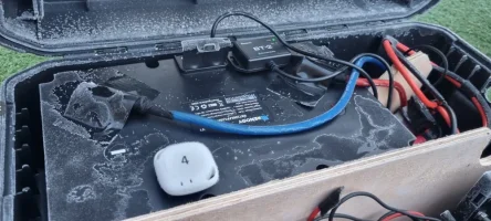

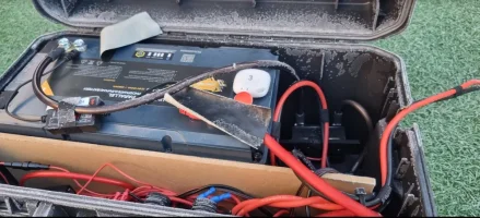

so i opened the boxes . .

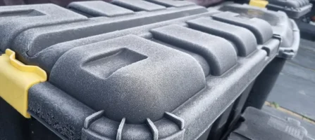

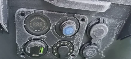

jumping out of bed the following day like a kid on Christmas morning i looked out the window to a frosty winters morning . .
just what id been waiting for . . . . for almost a whole year (sure i could empty out the kitchen freezer to do the test . . . but think id have to deal with the world war 3 aftermath).
This what i saw the following day . . .
1641719726981.webp1641719737724.webp1641719759552.webp1641719775665.webp1641719789085.webp
the battery's were showing a solid 0degc - perfect.
the temp sensors i added to the boxes we having a metldown . . . they were showing -5 degc .

we have the Poweroad LINC INFI 100Ah - 12V 100AH POWEROAD INFINITY SUBZERO LOW TEMPERATURE LITHIUM LIFEPO4 BATTERY WITH BLUETOOTH MONITORING - Alpha Batteries
and the Renogy 100Ah w/self heat - 12V 100Ah Smart Lithium Iron Phosphate Battery w/ Self-Heating Function
first up is the

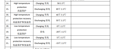

The spec sheet shows:
discharge allowed down to -20degc - recovery at -15degc.
and charge allowed down to 0degc, then blocked - recovery at +5degc.
further down we can see the heater mentioned . . .
BMS heater on <0degc and off >10degc (off above 10degc)
we start the test with the BMS readout.
it shows 80% SOC and a temp of 0degc,
the RED alert warning LED is lit warning that the battery is very cold . . .
but no alarm on the BMS panel . . .
the battery was allowing outgoing power and showed a good healthy 13.3v at the terminals . . . even at 0degC !!! (try getting that from an AGM!)
next up was to choose a charger . . .
i went for the Victron IP22 BSC12/30/1 a 30A charger with bluetooth built in - Victron Energy Blue Smart IP22 Charger 12/30(1) 230V - BPC123042022 : Amazon.co.uk: Automotive
switching the charger on we get some interesting info . . . .
using the Victron smart shunt inside the battery box - https://amzn.to/3f3TUeO
we can see that the charger is delivering 8A thats going into the battery . . . BUT the battery BMS is showing 0A going in.
this is confirmed by the charger app. . .
we can see that the battery is taking 8.0A from the charger and usinng it to power the internal heater - at this point it is NOT charging the battery.
15mins later thing change . . .
you can see that the battery internal temp has risen from 0degc to 5degc,
at this point the battery has started to draw 13A from the charger . . .
its still taking 8A for the heater.
and the rest . . 6A is now going into charging the battery . .
again confirmed from the charger showing 13A being drawn but the battery.

here you can see it settles to around 10A - this is due to the battery being 80% SOC do has diminishing current draw as the battery voltage increases proportionately.
again confirmed on the charger . . .
here we can see the thermals for the process . .
the battery shows a marked temp increase.
the box and surrounding area is still cold . .
the charger done a great job . . .
The final result:
battery nice and healthy and above 10degC . . and charging at full rate.
the full heater and charge curve can be seen here . .
View attachment 140947View attachment 140948

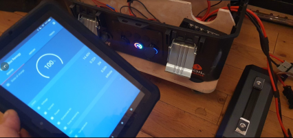

Next up is the Renogy 100Ah W/Heater version
here's the battery before connecting to the charger . .
The APP on the phone shows the BMS data.
to connect the APP to the battery you need the BT-2 Bluetooth dongle. - BT-2 Bluetooth Module for Renogy Products w/ RS485 Port
or you can get a separate stand alone screen. i have the BT-2
you can see the APP has flagged a warning for low battery temp. PROTECTION.
the BMS shows the battery at 0degc. - 78% SOC, 13.0v
start test @ 1000hrs . .
its nice and frosty . . .
connecting the 30A Victron charger we get a steady 3.4A being draw by the battery.
again this is not being shown in the BMS as charging the battery . . . . so the 3.4A is being used by the internal heater . .
The BMS has blocked any incoming charge current to protect the battery, due to it being too cold internally.
15mins later we still have the same situation. . . . 3.4A being drawn by the battery for the heater.
then at about 30mins things changed. . . .
the charger showed 9.1A being drawn by the battery.
the battery BMS was showing 6.0A being used for charging, - so it had now remove the charging block and was allowing charging at a reduced rate.
but the Victron shunt was showing 9.2A meaning that the heater was still drawing abound 3A or so. . . .
the battery temp had risen to around 4/5degc. and the BMS was letting the battery take a charge.
the warning had also changed from low temp PROTECTION (charge blocked) to low temp WARNING (charge allowed) .
the reading was confirmed by looking at the charger output . . .
at around 10degc internal battery temp the red warning bar disappeared from the APP screen.
but you can see the heater is still drawing power. . . . @ 1045hrs
by 1050hrs we had finally reached above 10degc internal battery temp and the BMS had turned off the heater.
you can see the response on the shunt readout,
the BMS APP is now showing the full 7.6A being drawn is going into charging the battery, with now power going to the heater.
these are the thermals . . .
at this point we can see the current start to drop as the battery reaches a higher SOC . .
Test End:
