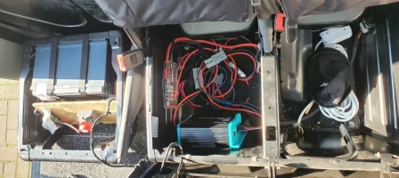

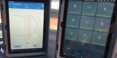

testing continues . . . with the second PRLC-100 - this time in the van.
20A Renogy DC-DC
Fuse Bock
Victron quick connect
BM2 + Victron Smart SHunt
Poweroad PRLC-100 Lithium 100ah battery
Isolator switch.
we using the Renogy 20A dc-dc on lifepo4 mode@ 14.2v
interluinked with this MIDI fuse block.

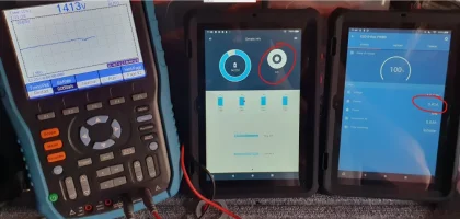

cha\rging data.
here we are over the 100% SOC on the BMS - but the battery is still taking 20A charge current...
then the BMS kicks in a blocks the charge current due to the "cell over voltage alarm" . . . .
the BM2 battery monitor is showing the 14.2v that thecharger is putting out . . .
but the battery is showing its internal voltage of 13.29v as the bms starts balancing the cells.
the final result . .
the battery is 100% charged.
the bms has blocked any incoming current - shown as 0A
The charger is keeping the system voltage at 14.2v
the battery internal voltage is dropping as the cell balancing continues.
the 12v system at this point is being powered from the dc-dc charger - around 3A, its not shown on the shunt or the battery as its not bing sourses from the battery, but a clamp meter shows the 3A coming from the 20A Renogy charger.
enigine switched off - test end.
more testing soon..
FYI - the Victron shunt was set with the Lifepo4 settings above.

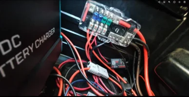

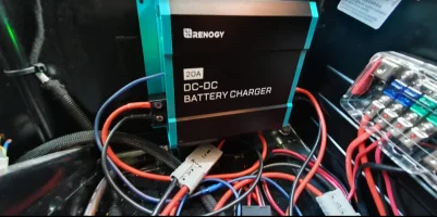

20A Renogy DC-DC
Fuse Bock
Isolator switch.
cha\rging data.
View attachment 126077View attachment 126078View attachment 126079
View attachment 126080View attachment 126081
more testing soon..

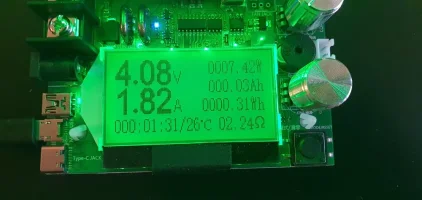

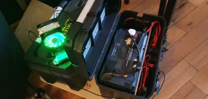

Test started...
SOC @ 100% On both battery and shunt..
Constant load connected . . 0.8a.. (1.8a from 5v USB charger = 0.8a @ 12v
from battery) shown by Vic SS, but NOT shown by Battery BMS.
Well leave it for 10hrs and see what happens.
20210813_172406.jpgScreenshot_20210813-172305_Poweroad.jpg20210813_172218.jpgScreenshot_20210813-172158.jpg20210813_171134.jpg

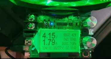

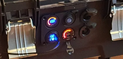

test results so far . . . the following morning.
14hrs in . . . . electronic load is showing 26.25ah @ 5v drawn.
front poanel shows 13.0v.
battery BMS shows 100% SOC and 0.0A being drawn and STANDBY status . . .
Vic SH shows 89% SOC and 12.1ah @ 12v drawn. (so roughly shows the same as EL when corrected 12v vs 5v / ah )
this is the Vic SH battery setting page . . . 100ah battery with 99% charge efficiancy.
BM2 plot to follow.
ill leave the test running to see what happens . . . .
edit:
24hrs mark . .
EL shows 43Ah drawn.
battery BMS shows SOC @ 100% still . .
Vic SS shows 82% SOC . . . and still metering the 0.8A load draw.
TBC
View attachment 127090View attachment 127091
View attachment 127092View attachment 127093View attachment 127094
BM2 plot to follow.
View attachment 127096View attachment 127097

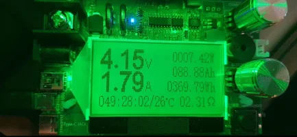

mid test results added to post above . .
current test results.
49 hours in . . . drawing 0.8A from the battery.
88ah @ 5v
battery BMS shows battery still at 100% SOC.
with no draw and standby status.
Vic SS shows battery at 63% SOC with the 0.8A load draw.
thats 41ah @ 12v
interestingly the battery hasnt gone to SLEEP yet . . .
i think the 800mA draw is under the 1.0A sleep point . .
but with the BM2 transmitting data to the phone we must be just be resetting the SLEEP timer.
800mA + 200mA ? - thats most likley whats happening.
BM2 readout . . . . shows battery online for the 49hrs duration.
to complete the test ill fully charge the battery back up to full and see how many ah it takes. . .
TBC . . .
