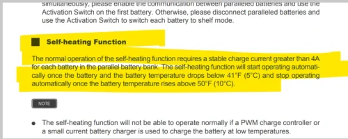

The Renogy heated had two heaters that need 4A each.
So 8A charge source is needed for correct operation.
I think they added that to the user manual..
I'll double check and pay here.
edit:
4A per battery - so charger needs to be 5A plus for the heater to work.
Self-heating FunctionThe normal operation of the self-heating function requires a stable charge current greater than 4Afor each battery in the parallel battery bank. The self-heating function will start operating automatically once the battery and the battery temperature drops below 41°F (5°C) and stop operatingautomatically once the battery temperature rises above 50°F (10°C).

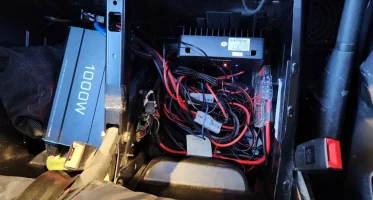

On my renogy dcdc charger I've left the temperature probe disconnected and you can see in the app the temperature defaults to 25 degrees C. This enables the charger so working Sub-Zero temperatures.
eg on Renogy DCDC with NO temp sensor plugged in:
-3 outside but charger defaults to 25c.
I've added the Renogy dc-dc temp sensor.
Now we can see the Renogy charger showing 7degC.

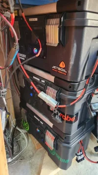

Im running a Vic MPPT in the solar shed,..... But have a mix of heated and non heated lithiums in a @Dellmassive battery box stack... So for now I'm running the default profile. Which is low temp charging disabled.
heres the Renogy DC-DC with the temp sensor added. . . .
-2.0 ouside van . .
Renogy temp sensor set here floating about.
APP now reads -1.0 as has a warning - Lithium low temp protection.
the Victron shut agrees and shows -1.0c temp

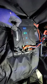

warming us the Renogy temp sensor with my hands to 8.0c, the low temp warning clears and the charger starts charging again.
30A to the Fogstar drift in this case.
note that you cant change the LTP setting on the Renogy APP. so to alow charging below 0c you need to unplug the temp sensor - provided you have a heater battery.
