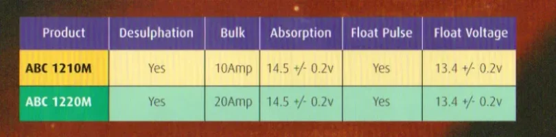

@Dellmassive could you please advise if my existing battery charger is suitable for charging the Valence U27-12XP.
It’s a Elecsol Auto Multi-stage, model ABC-1210M.
Thanks
From what I was reading in an earlier post the Elecsol charger (above) meets the voltage requirements but it only shows one absorption process, not two absorptions as required.
Can anybody clarify, out of my depth on this one

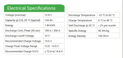

the spec sheet of your charger shows,
10A 14.5v absorbtion and 13.4v float.
and the battery spec sheet says :
14.6v charge voltage,
13.8v - 14.6v float charge
<72A CCCV in amps.
Recommended Charge CCCV≤ 72 A to 14.6 V
so 14.5v +/- 0.2 will charge the battery, but possibly not fully and as quickly . . . (I've got away with 14.2v on the Victron chargers and it been ok)
and at 10A it will be running flat out and probably get hot. . . .
so id say give it a go for now, but look at getting a more modern EHU charger that states Lithium Profile and is capable of reaching 14.6v at the max Amps without getting hot.
look at the branded options like Victron.
also Lithium's just have two charge stages . . . Bulk/Absorb and float.
They will suck in as much Amps as you can throw at them (up to the rated max, for the valence its 72Amps), untill the voltage rises to 14.6v . . .
at that point when the voltage is around 14.6v and the battery is drawing less than 1Amp its classed as charged.
this is when the charger should drop to float mode 13.8v - 14.6v float charge to maintain the voltage.
once the charger is removed the battery rest voltage will be around 13.6v ish . . .
