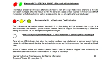

Hi just purchased 4 valence batteries for my camper but have a problem with one. The green light is on permanently rather than flashing like the other 3. Anyone know how to fix this?
Kind regards
where did you source them from?

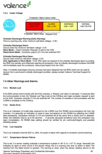

you can interrogate the BMS withe= the cable and software above,
I've also posted the manual,
what therest voltage of that battery and the others?

In my opinion the system onboard the Victron battery is a cell balancing system. Not a battery monitoring system. Without a separate BMS the battery will not stop accepting charge if the temperature is out of range, It will not disconnect the load if there is a problem within the cells, in fact, it will do nothing. With one of the 4 separate BMS's from Victron, plus a battery disconnect and charge disconnect module, if there is and internal problem or the temperature is too cold or hot the battery will be prevented from charging and or the load disconnected automatically without user intervention. That IMO is a battery monitoring system.
