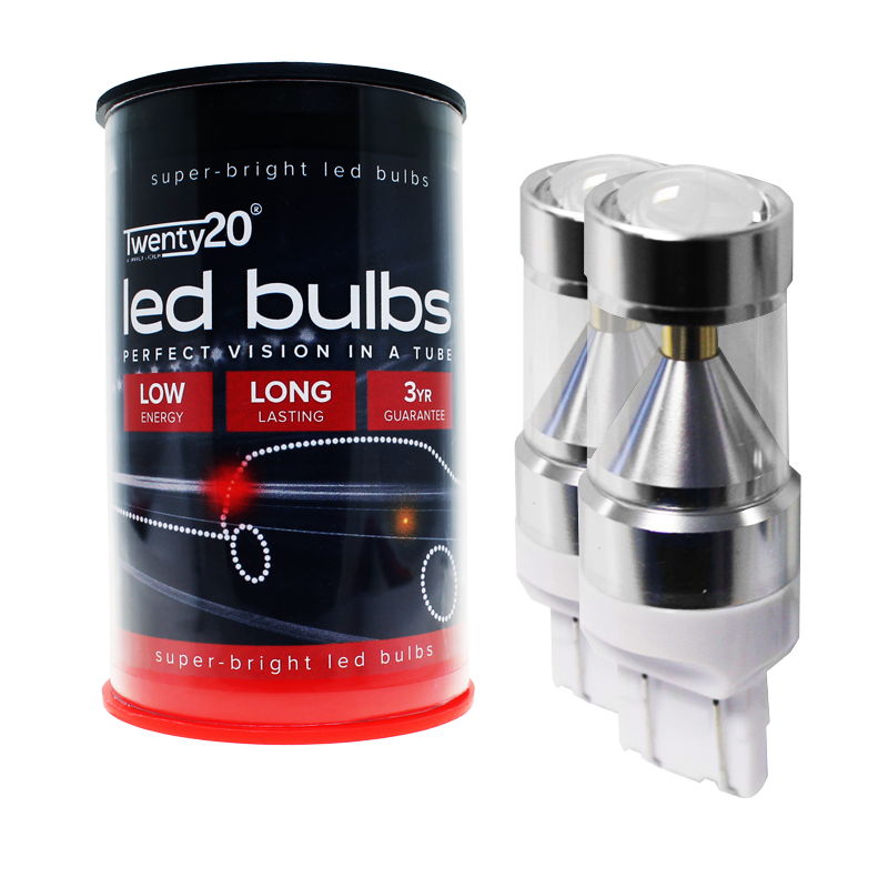

2. Those ‘better’ CanPlus LEDs from Twenty20 - They look awesome. they are *much* longer than the older version and nearly twice as long as the halogen bulb. There was no way these were going in using the traditional method. I had the headlights on the dining room table with a small torch so I could see clearly why they fouled. The only option was to remove the plastic extension piece from the bulb holder (just unclips) then fit them without the extension. Either they can deal with either polarity or I luckily guessed correctly in both cases. Assuming they don’t fail, I calculated it will take me 250 years to reach the end of their life so now they’re in, I feel good about them. There are no CANBuS errors with ignition on. Haven’t driven it yet.

WARNING: Do not do what I did. Those ‘better’ Twenty20 CANBuS bulbs have near-on destroyed the DRL holder. I got a dash warning and found one was actually out. On inspection, the contact has melted INTO the body plastic of the bulb?!??! The holder is now just holding on for dear life. I replaced with normal bulbs until I figure out what’s going on. I cannot recommend these bulbs for this application. Steer clear.

So although website states they are compatible with T6 they are simply too long??
Worrying as I've already ordered them.
Too long and they melted after about 2 hours of use. I'll be sending mine back.
