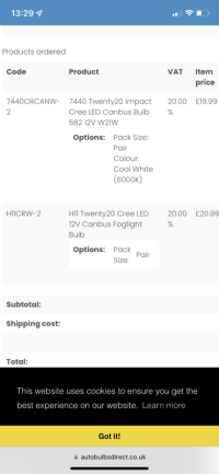

Thanks very much, think this answers the question that I need to get the correct bulb to ensure correct resistance so bulb out dosent come up, and can’t just rely on fixing everything with Carista or VCDS. Much appreciated.
Also if it makes a difference it’s a 68plate Highline Kombi.
Here’s what I fitted from Auto Bulbs Direct.
