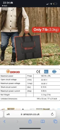

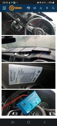

Did I read it right earlier that you can just plug a solar panel with controller straight into the cigarette lighter socket to charge the starter battery?! I haven't picked up my van yet..... But does this still work with the ignition off? Or did I miss an extra modification that's needed? I'm not good with electrics.... Sorry for the dumbass questions... There will be more I'm afraid.
I plan on adding a mobile solar to my setup when I get it. I was thinking that my preferred solution would be to hardwire the mppt controller onto the leisure battery and have a long extension cable to my panels so I can move them around.
