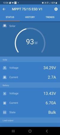

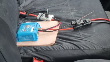

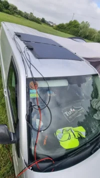

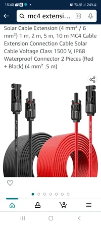

Should be fine on that basis <24v…I’m going direct from panel to ctek (no controller) and using an extension to the wires that came provided, I had to crimp and heat shrink larger lugs to fit the ctek.
panels work fine when plugged in via controller to charge phone etc.
