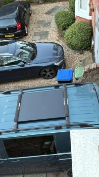

How about a rigid set up like this?
....or have a microwave, an induction hob and a coffee machine :rolleyes:
That deserves a thorough head examination or a campervan interior design award… fitting all of that inside a SWB transporter is impressive! 😂
