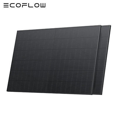

Think I’m going to go big to make the effort worth while.
I’ve seen these. Are they worth the hefty price tag?

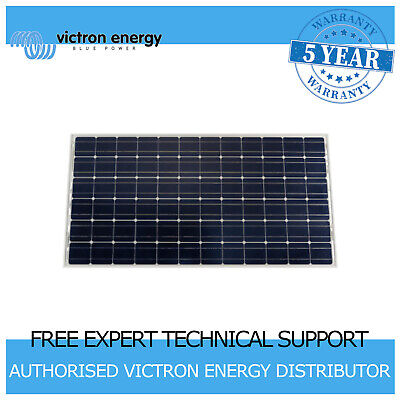

Nice, go big or go home! Just be aware the correct size MPPT will be quite big for 300w+ of solar, you're looking at an MPPT 100/30.
Have you got a size constraint?
Victron do a 360w panel, £166 delivered on eBay. Same place I got my 305w panel from.
That ecoflow listing implies it might be 2x panels? Not sure though

That victron 360w panel looks great. Much cheaper too.
I did wonder if the ecoflow was 2 x 200w panels.
