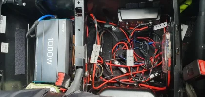

LOl . .Having one of these bad boys fitted in December by Absolute5
Phase 1 of the upgrade process.
(Unless someone decides to donate a couple of grand! )

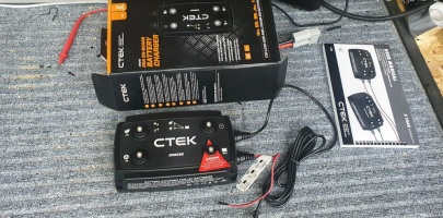

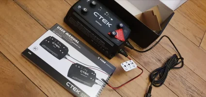

i finally got around to getting a CTEK D250SE from a forum member for some testing. - https://amzn.to/3jbFJqP
what the spec says.
Description
Dual input 20A charger with selectable charge voltages
The D250SE is a fully automatic, 5 step charger that supplies up to 20A of power to any 12V lead-acid or lithium* service battery from 40–300Ah. It has selectable charge algorithms for AGM and lithium* batteries and can use power through its dual input from alternator and solar panel. When the service battery is fully charged, the D250SE will automatically redirect maintenance charge power to the starter battery. The D250SE can maintain a stable output up to 20A to vehicles fitted with smart ECU controlled alternators and also has a temperature sensor for optimised charging, regardless of weather conditions. *) 12V lithium batteries (LiFePO4, Li-Fe, Li-iron, LFP)

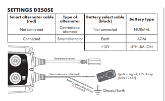

Battery select black wire - (+12v for Lithium)
EU6 select red wire - (+12v for stop/start EU6)
following the guide:

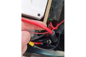

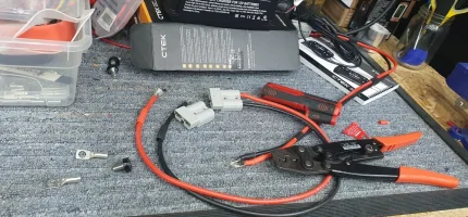

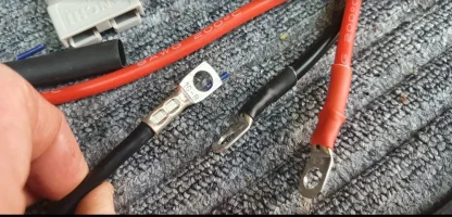

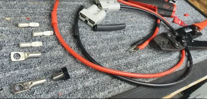

we will be wiring it up with the standard 50A Anderson connectors so we can swap units in/out easily.
starting with a few connectors and heat shrink plus crimps.

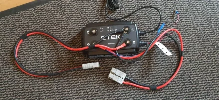

we make us a few link cables . . . using 8AWG Silicone cable.
we end up with this . . .

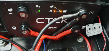

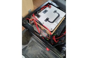

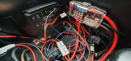

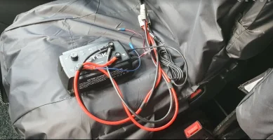

dropping it into the van seat bench base with HD Velcro. . . .
we can start testing.

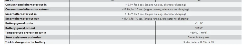

The Auto VSR feature kicks in around 13.1V. (with no IGN feed connected)
with the IGN feed the charger will start/stop following the Engine BCM run signal.

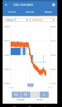

we can see a solid 20A from the charger,
18.85A logged going into the Poweroad 100Ah Lifpo4 battery.
it looks a bit messy . . . but its all functional and safe.

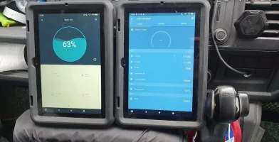

you can see the charger reacting the van engine on/off/on . . .
and the BM2 showing the battery charging as the voltage starts to increase. . . . . . .

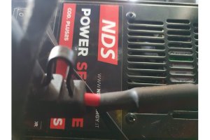

Temp wise the Lithium battery will pull MAX current from the charger . . . . so 20A from this unit.
after about 30mins the front of the charger was very warm to the touch, but not too hot.
the rear of the unit seemed to stay cool.

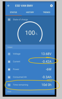

Then there is the strange charge profile that leaves the battery draining down while the engine is running after the battery is fully charged . . . =[
here is the testing . . .

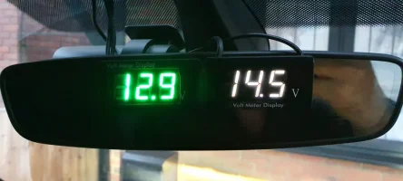

After starting the van for a journey back from work the Poweroad Lifepo4 battery was fully charged to 14.2v (Bulk) by the charger within a few mins . . .
but what happens next just doesnt happen with other chargers . . .

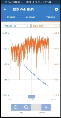

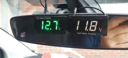

over the next hour of driving the battery is actually discharging !!!!!
The Ctek has decided that the battery is fully 100% charged to 14.2v, (bulk)
so its moved over to the FLOAT stage . . . . which is 13.3v
you can see below over the hour the battery voltage dropping as its being discharged by the phone charger buy about 0.5A !!!!!!!!!! WTH.
these reading are confirmed by the CTEK D250SE pdf as the correct charge strategy for a Lifepo4 battery type . . .
this is also confirmed via the Victron shunt showing the battery DISCHARGING and not CHARGING for the whole hours drive !
other chargers will show a Positive charge going into the battery,
and will show on the Victron as "time remaining - indefinite"
so what's going on?
well the CTEK wants to drop the battery voltage to 13.3v as per its charge strategy . . .
in doing so its now not charging the battery . . . . . its just waiting for the battery voltage to drop that low before moving into the PULSE stage.
but during the hours drive the battery has actually DISCHARGED by 0.5ah . . . that's not good =[ .
this can be seen on the Victron as CONSUMED Ah (-0.3Ah on the screenshot at the time)
why have we consumed 0.5ah when we are supposed to be fully charged !!!!

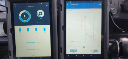

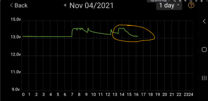

for balance here is the BM2 plot.
here is a 3hour drive showing the drop off . . .
here is a 7day plot showing the charge curves . . .
so you can see that it does effectively charge the LB overal,
but i don't like the charge strategy firmware . . . it seams odd to charge the battery to 14.2v that most lithium's need and then to stop the charge and let the battery drop to 13.3v . . .
before then restarting the cycle and bulk charging back to 14.2v again?
