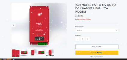

Dell [email protected] you yet aware of the new Dc to Dc chargers from sterling power :
The sheer amps I find staggering.

While LiFePo batteries will take huge amounts of charging current, the only problem I can see is that you'd have to rate all the cables from starter through to leisure battery to take the amount of current that the DC/DC charger could take, so 120A over the, say 3 metres between engine bay and under seat area (or further if the charger is located under kitchen units in a camper) would need 35 to 50mm2 conductors, the cost and ability to terminate that size cable onto the respective parts of the system would be the limiting factor, you'd have to size any connectors and cut off switches accordingly.
You'd also need the uprated Alternator as well wouldn't you - I thought the standard T6 alternator was 140A max - I wouldn't want to take 120A from that for any period. Even the 70A sterling DC-DC sounds challenging

Thanks for the kind words and link Stu, @Soundz
gotta say 70A and 120A is a big jump from the current 50A offerings. ( like Redarc bcdc1250d 50A )
120A will defiantly be a Alternator killer for most. ( i have the uprated T6 alternator, its supposed to be 180A but its listed as 2000W in VCDS?)
and as @Grim Reaper points out you need some beefy gauge cable all the way through.
it reminds me of my old BMW 520D, the AGM battery was in the boot tucked away . . . the car had a massive Bus-Bar type cable running up to the engine bay (was run under the car along with brake lines) via a jumper starter point, down to the starter with a second fat cable from the starter to the alternator. - it needed to be that thick to stop the huge volt drop when pulling 200+ Amps
edit:
just seen in the Sterling docs that its advised to get a DC-DC charger rated to 70% max of the Alternator output.
thanks to @Soundz for the heads up . . .
Sterling power release 70A & 120A DC-DC chargers . . .
this is the BB1270 70A unit. - £450 - - https://cdn.shopify.com/s/files/1/0658/7343/files/BB1270_manual.pdf?v=1635868907
BB1270
Input voltage range 9V-16V
Rated output power 60A at 13.8V
Rated input current 70A
Quiescent current 10mA
Efficiency rating 92%-94%
Self recovering protections: under voltage protection
input over voltage protection
output over voltage protection
over current protection
charge over temperature
Operational Temperature -20 Deg C -> 60 DegC
Approval CE | UKCA
E-Marking
Cooling method Thermostatically Controlled
Variable low speed fan
Dimensions 200mm x 130mm x 56mm
Weight 1.0Kg
and the BB12120. 120A - £600 - https://cdn.shopify.com/s/files/1/0658/7343/files/BB12120_manual.pdf?v=1635345051
BB12120
Rated output power 110A at 13.8V
Rated input current 120A
Approval CE | UKCA
E-Marking
Dimensions 270mm x 130mm x 73mm
Weight 1.8Kg
