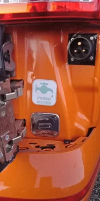

I don't see anything wrong with the VW California combined EHU and water fill point, I've fitted them on at least three LWB T5s & T6 and they look (in my opinion) and work very well.B2B is battery to battery, so not going to be able to plug it into the mains.
You'll need a separate AC to DC battery charger.
And don't put the hookup on the side of the van, looks awful IMO.

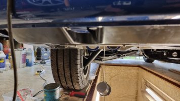

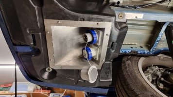

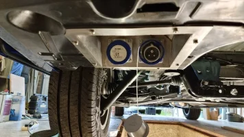

Very nice....This is what I made, I wanted 240 ac input and output.
Can't beat a bit of over-engineeringThis is what I made, I wanted 240 ac input and output.
