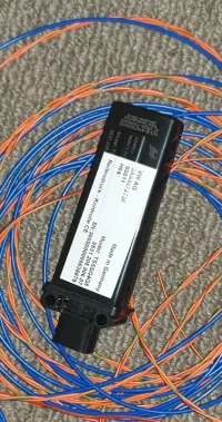

Bits being collected for this one too.
Loom and Rx from the 'Bay. Annoyingly the +12V and GND are the wrong way round. I can't seem to get the pins out. I'll just join on another length of wire.

Rx module installed, although will probably move it under the NS plastic cover as mentioned earlier in the thread.

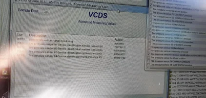

All installed and coded, but no pressures being received. Dash display there, but showing dashed lines from each corner.

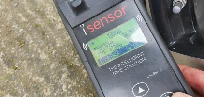

The sensors are working as tested with this MaxiTPMS tool;
I've moved the receiver to several different orientations, but nothing.
VCDS indicates that it's never seen anything;
All sensors show same ID & 25.5 bar !
Edited to add; Sensor ID above 4294967295 is 2^32 (when starting at 0), so that's a made up/system default I guess.
I'm out of ideas now chaps.

i know why doesnt work 4u ,
You have to added all sensors ID manual and match with each wheel .
so read ID of all your sensors .
go to 65 / adaptation / add ID of your sensor and add which wheel is it . done .
ignition off 10sek and back on
again go to 65 / adaptation / add ID of your next sensor and add which wheel is ..
do that 4 times
so after that your module will c all sensors check picture .
Now do calibration in 65 module / basic settings
i dont have a special tool so i use strong magnet
pickup of list calibration tyle 01 and go to 01 wheel with magnet
30sek , pressure icon will flashing on speedometer click stop
type 02 and go to wheel 02 and do the same .
03 and 04 and go for drive .
