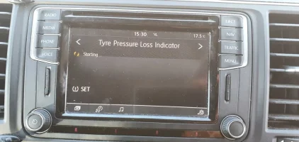

Pressure readings are blank in the IC initially cause all sensors have entered battery saving mode while the vehicle was stationary :thumbsup: .
