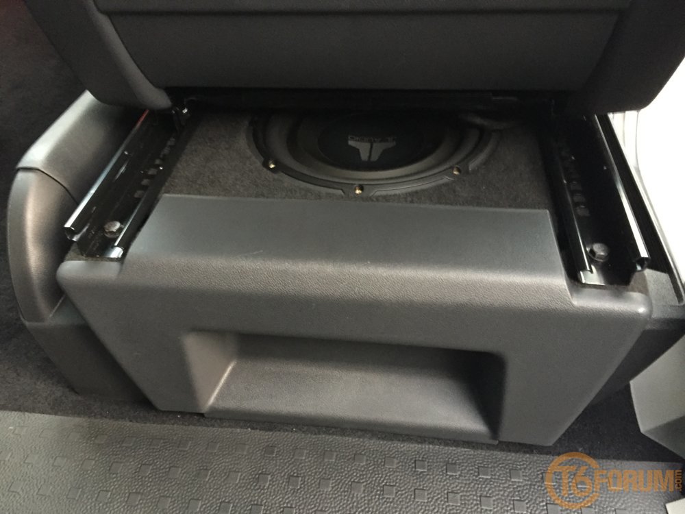

So today I wanted to fit my sub box and amp under the drivers seat

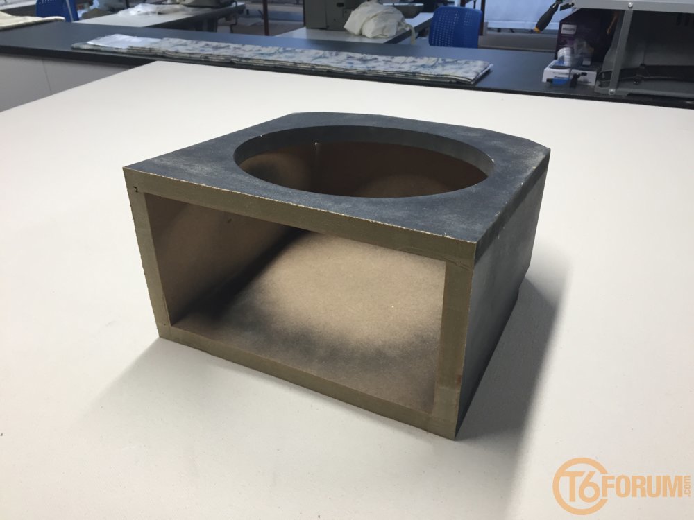

This meant seriously altering the box. First I shaved off the corners to allow the box to fit as far forward in the seat base as possible
The cut opened a hole in the box, but the piece I cut off was exactly the correct shape to glue inside the box and fill the hole :geek:

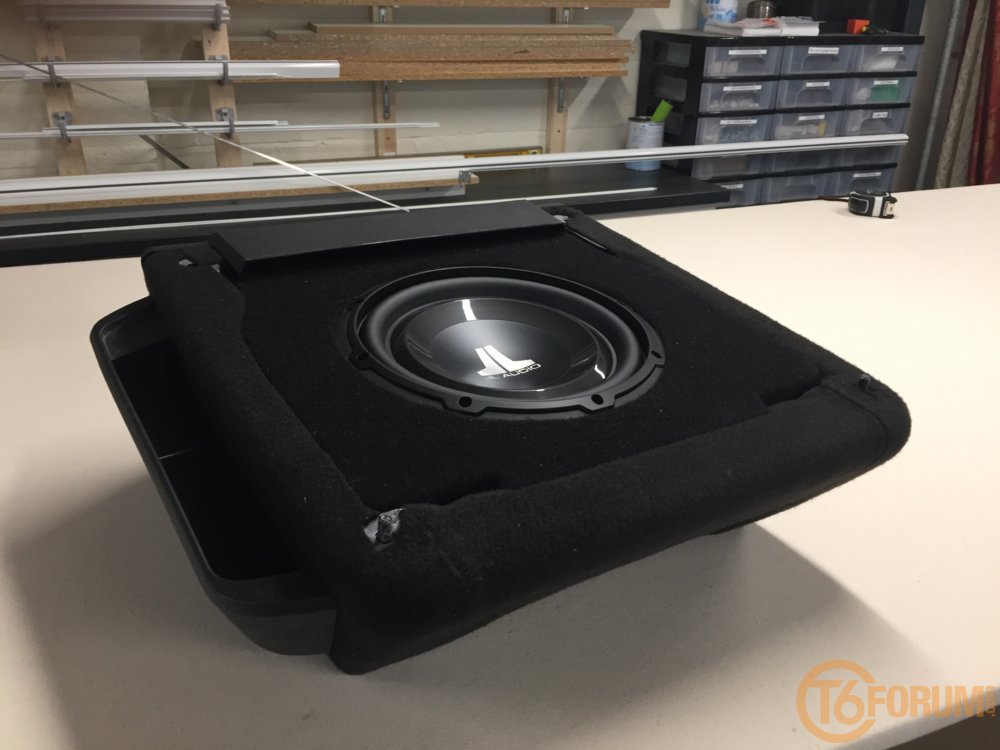

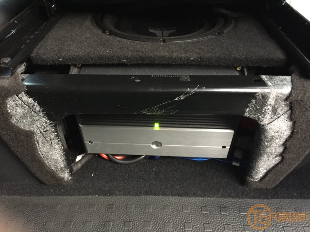

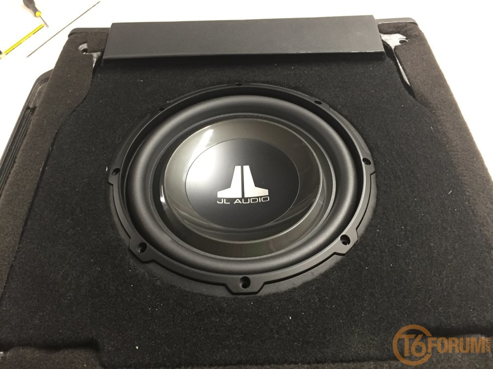

Next I sat the box in the seat base and worked out how much I had to cut off i shaved down the old back and glued it back in place. Making sure it was sealed all round. Then I screwed the amp onto the back of the box and tried it in the seat base Result... the controls for the amp were completely accessible, ideal for fettling :cry: after peeling back the carpet and trimming the top board I carpeted the seat base and fitted the sub in.
