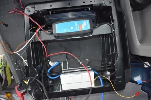

Soooooooo. The roof is done. The dashboard is now black to match the door cards. Only slight problem is I’ve knackered my CTEK dc-dc charger. My solar panel is a 250w. It’s output is 37 volts. Despite having checked this or so I thought, the CTEK will only allow a max input of 23v (150w). So back to the drawing board.
View attachment 19758 View attachment 19759 View attachment 19760

I've heard back from Redarc and my panel is definitely to high a voltage, the same must be true for the Ablemail too as that is the same spec. I've found a Ring DC-DC charger that will accept a PV input of up to 50v so this would be fine, only problem is it's massive and won't fit under my seat. I'm going to replace my CTEK with a new one as all the wiring is in place already for this then connect the solar panel directly to the battery via it's own separate MPPT controller. Hoping I can find one small enough to shoehorn underneath the seat. :geek:
