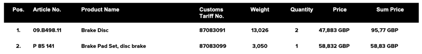

Be aware the prices change often so if in no rush monitor the price fluctuationsI’d have no hesitation using Brembo discs from somewhere like EuroCarParts who always seem to have discount codes. Just checked out the website and two 308mm vented discs with discount applied £120. I’d get the matching brembo pads. Pagid also a known brand (make a lot of racing brake pads)

How long did they take to turn up..I bought my Brembo disks and pads from Autodoc
