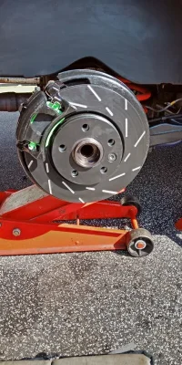

I’ve just fitted some to my camper. EBC themselves recommended the same discs but with the (Apparently) new yellow stuff pads.Im looking at some replacement Discs and pads for my T6 t32.
I have been looking at the EBC discs and pads. Has anyone got any experiance with these?
