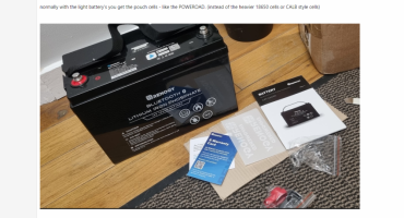

My Renogy battery has just turned up and I understand it is in shelf mode for storage, and as such I cannot connect to it via Bluetooth to see SOC etc.
Is there a quick and dirty way for me to pass draw / supply 1A to wake it up?
I'm just collecting parts at the moment so I'm not in a position to be able to connect it to the DC charger. Thanks.

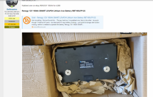

If you'll excuse the dodgy wiring, I think this should be enough to satisfy the 1A draw?
I'm still getting nothing from the terminals and the tyre inflator isn't turning on.
From this I assume that it does in fact need a proper charge, which for me will be installing the DC50S.

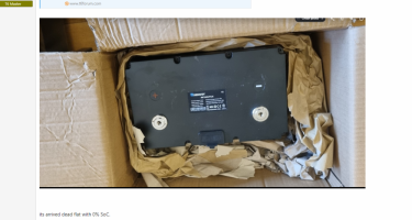

Just following up on this, the IP65 is here and doing it's thing.
Not sure if my multimeter is faulty though, I'm still getting no reading across the terminals :cautious:
wow 10% . . that very low. ( but you mentioned it was a reman`)
that 15A charger should have you fully charged in around 6.6667hrs lol
IP65 set to lifepo4,
fully charge a couple of times.. .
when it goes right to float, and the battery pulls less than 1A its considered 100% full.
