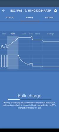

The IP65 has a charge profile that can have set times between charge stages....
For example 4hrs max absorption...
Meaning the charger will move to float or storage mode before the battery is actually fully charged.
So pressing the mode button on the charger restarts the charge cycle......
When the charger moves to float with in a couple of mins you know it's deffo charged.

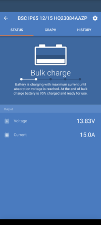

The charger app will show you the charged Ah gone in.
And the battery app will show you the SoC.
You have a 15A charger so it should take no more than 6-8hrs..
Post some pics of.your apps and that.
