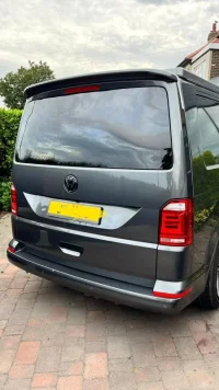

Tailgate conversion done. I’m really pleased with it! just a few electric faults to sort..
i’ve had an issue with the auto door lock when driving away. it wouldn’t lock so I have now deactivated that in Carista. The problem is sorted however, I can’t lock the doors with the lock button on drivers door?
I’m also getting a warning light on my dash which I believe is because the tail lights are LED does anybody else have this?
