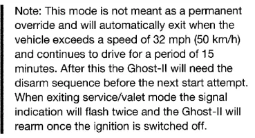

-FWIW, this is a picture of the relevant section of the Ghost manual:
Interesting - so it's not "speed exceeds 32 mph OR journey exceeds 15 mins", it's "speed exceeds 32 mph AND journey exceeds 15 mins".
I think that makes it a lot less likely that the Ghost will re-arm in the scenario I described. :thumbsup:
