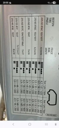

You should have a sticker like this in the driver's door area (on the door jamb with the door opened). This tells you what you can run for your van as per VW 'official'.
Other sizes will fit but then you'd need to probably inform insurance you're running non- standard tyre sizes. The sticker below is for my T32.
