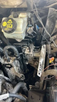

Hello friend I need help regarding the swap because I am stuck at this decisive step for it to work. Here I have everything is done (abs pump, acc mfsw button, coding). Thank youI found my own way by try and error debugging a lot .....
- Get a used Cluster from a T6 with ACC and the TransmissionBox you need. DSG or SG must match, that is important !
- Get the Cluster Immo Learned to your car (NOT with OdisE), but VIN in Cluster needs to stay the one from the Car where the Cluster was taken from.
- Get CP done Online with OdisE, get Swap restored online with OdisE, this works because it is restoring Swap for the VIN from the T6 that had ACC. (ECU can stay the same, the whole time)
- Now you can change the VIN in Cluster back to your VIN, CP and Swap will stay.
Took me 1 Year of digging ......
Regarding ABS.
Normly you need Q but i have seen one T6 with P and working ACC from Factory.
