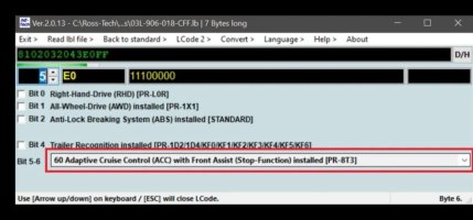

Coding advice is also welcome.
->search tell me that:
bcm 09 ->byte 5 ->change 60
probably something else is needed too.
I using vcds and factory odis at work.
I would appreciate your help.
Assuming that you have CCS via MFSW,
coding wise you need to apply the following:
ECU 01
ABS 03
Matching radar with your Instrument Cluster or disabling CP altogether.
Plus uploading appropriate SWAP to match your gearbox type and ACC max speed.
