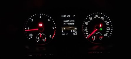

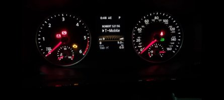

But does it actually work in the upper range :inlove:? Perhaps yet another video :sneaky:- with fuel consumption display on :laugh:
Indeed another amazing retrofit @Robert :mexican wave:- I do hope you can resist any temptations of T6.1 for a few more years.
Have a look below.
